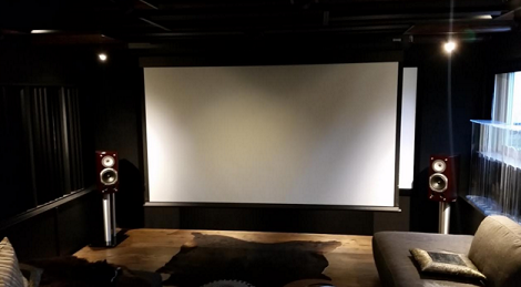

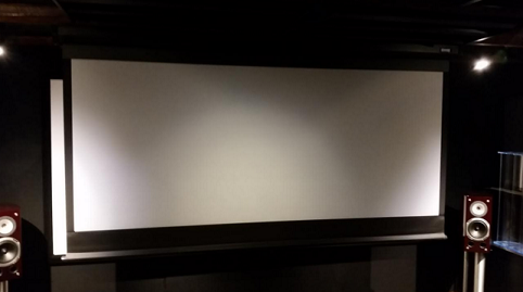

Hi,
I have one Da-Lite High Power 16:9 119 inch diagonal screen (263 cm wide image) and one High contrast High Power 2.40:1 format also 263 cm wide image for sale. The high power material is retro-reflective. This means that the light is focused back to the light source. To take most advantage of this, the seating position shouldnt be too far away from the projector. But if you have a shelf mounted projector there are big advantages. 1) First off they have an on axis gain of 2.4. This means that the image gets to be more than twice as bright as a regular screen. The difference is huge IRL, the image virtually pops of the screen in comparison. Perfect for 3D, some ambient light in the room, or if you have a projector that can close down an iris for improved contrast, like the JVCs. 2) Since it is retroreflective it doesnt hotspot even though it has a very high gain. I.e. the central parts of the screen doesnt get any brighter than the edges. This is very pronounced with regular high gain screens. 3) Since they focus the light in a narrow cone very little light spills back to the walls and ceiling. This really helps maintain contrast in less ideal environments, like rooms with white walls or celing. The 2.40:1 screen is a high contrast version with a light grey coating and a slightly more narrow viewing cone. 4) The coating is not very visible and provides a very smooth and fine image. Much less grainy structure than the Stewart Firehawk, SI Black Diamond and React high contrast screens. These screens also all have significant hotspotting. The drawbacks are the requirements of not too high projector placement and that if you have a very wide sofa the outer seats will get a dimmer image. These screens are no longer made and cant be ordered from Da-Lite anymore even if they are very popular. More info about the material can be found here: http://www.avsforum.com/forum/23-screens/773065-high-power-review-part-1-a.html The 16:9 screen has some scratch marks on the black border, but still provides an excellent image. Price 2000 DKK. The 2.40 screen is in good condition. Price 6000 DKK Both screens can be stopped at different positions from the ceiling and go far down if needed (extra black drop). You can come and demo the screens if you like, they are mounted in my theater outside Copenhagen. Let me know if you have any questions! You can write in either English or Danish. I do understand it, but my writing is terrible... ![]() BR Ted Redigeret af Ted - 02-December-2015 kl. 22:40 |
